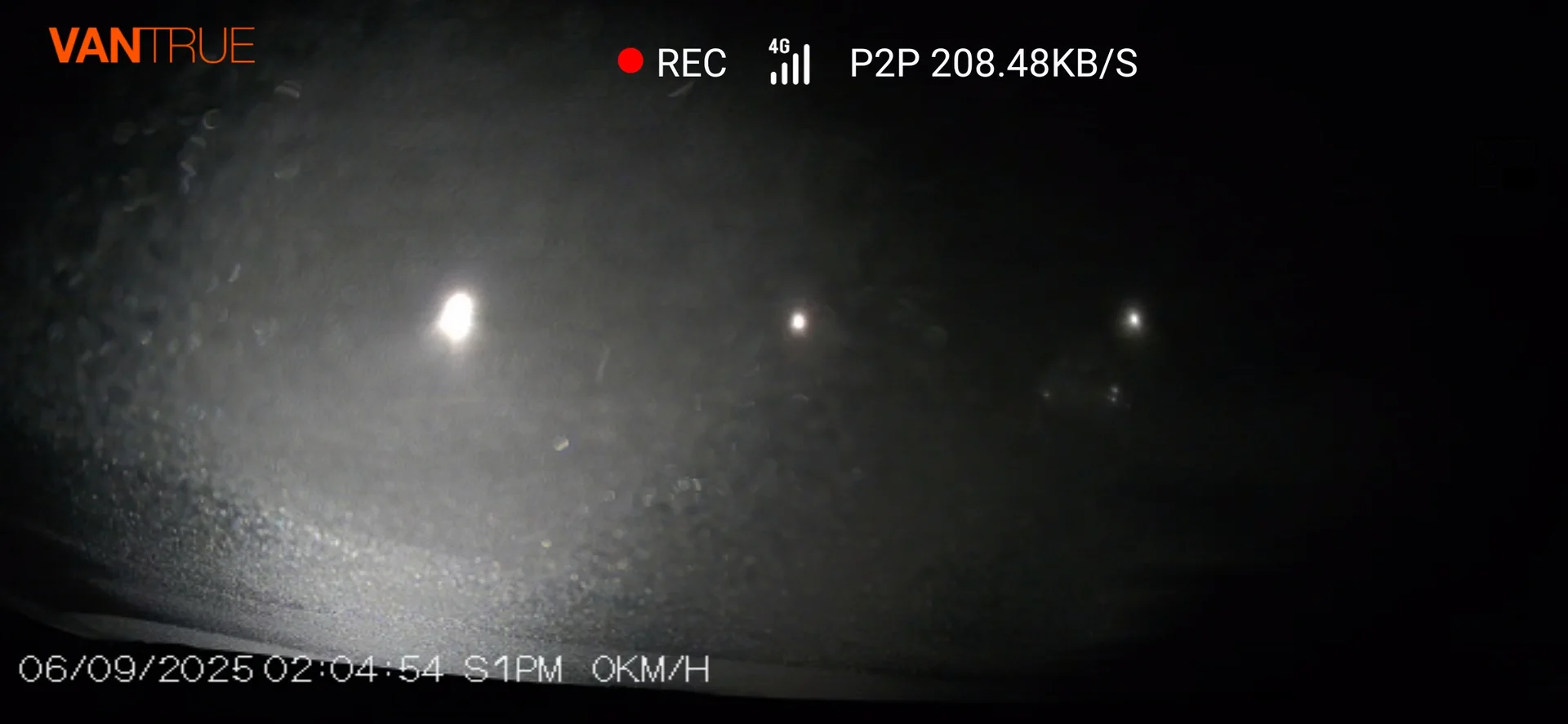

for instance right now at 2 AM here in Denmark, all my dashcam see is this.
The CCTV camera on my 2 floor balcony door see a bit more. ( less than optimal phone screen capture the raw footage is better on both dashcam and CCTV cameras )
with the optical zoom 1440p camera i will get a identifying shot if someone get frisky with my car, not really worried of vehicular hits where i park or out and about parking while shopping.
