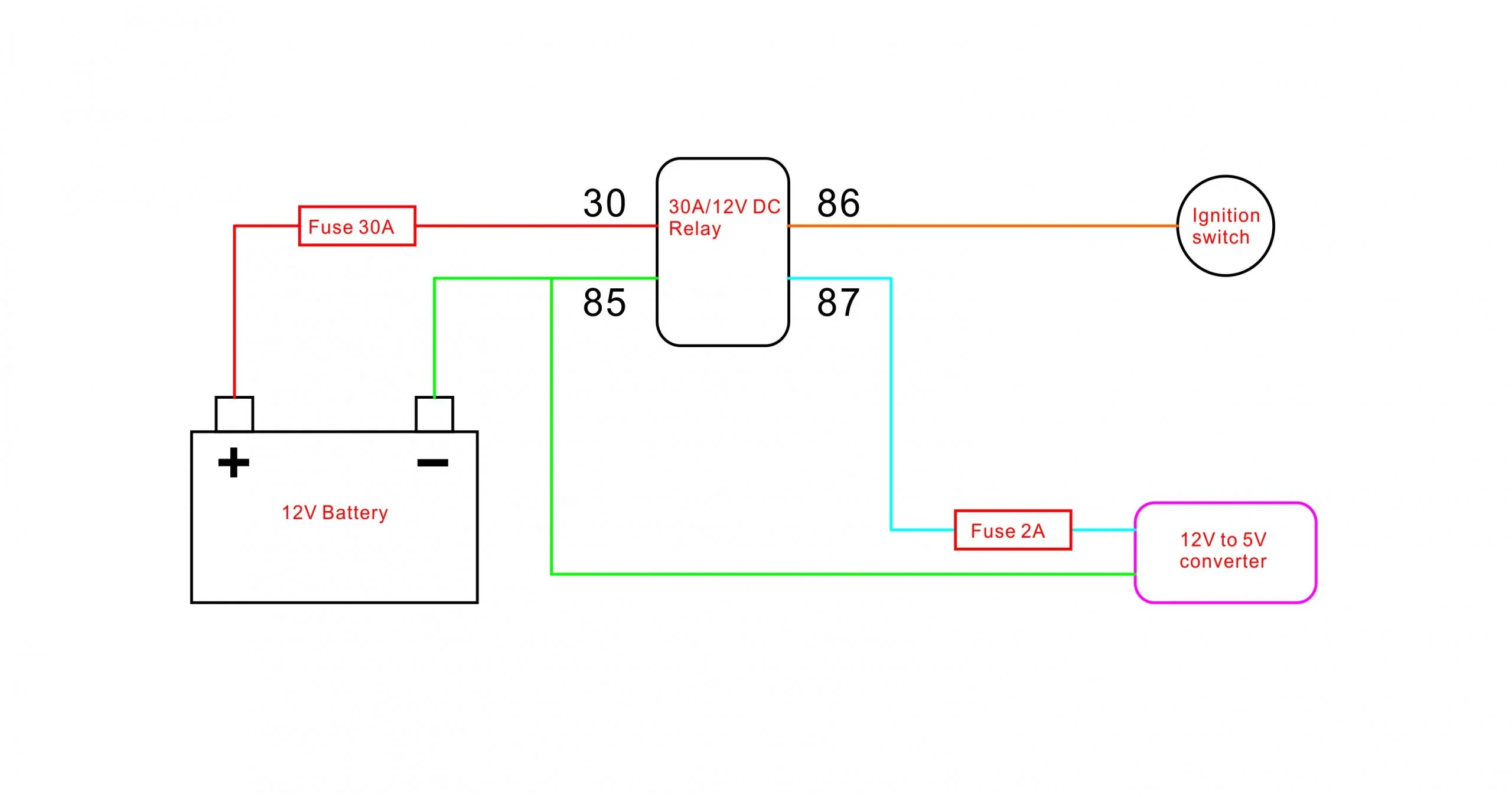

Approach 4 - Bring in a relay switch.
I went out and bought a relay switch(Novita RL44) and used this as a guide. The Pin 87 goes to power supply's red/blue wire combo. Pin 86 is connected to "add a circuit fuse". 85 is grounded and 30 goes directly to battery.
Same behavior.
Oh I should also mention, if I switch the ignition and turn engine on right away (as quickly as humanly possible) the camera comes on a records. But this doesn't give the bike time to do its diagnostics. I don't know if its "necessary" per say, but I am sure as heck not risking it (or adding the hassle of doing this everytime to my life) just to have a dash cam.
What am I doing wrong? Anyone have any tips? I like the thought of always have a front and rear facing camera, but I am starting to think its just too much hassle with innovv.
