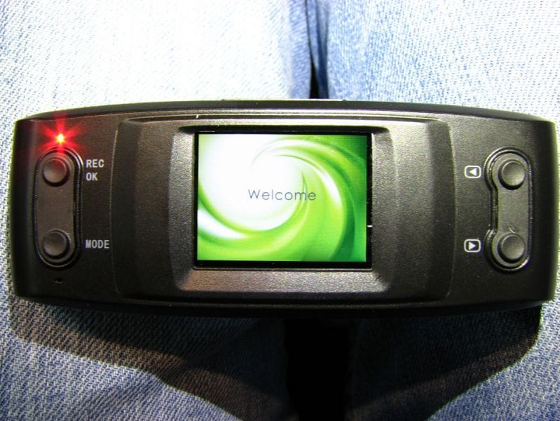

GS1000 Menu
This camera typically comes with firmware v2.0.3G1KB.  Older versions were 2.0.2G1KB and 1.1.1G1KB.  Also in the video recording, the date and time appear on the top left corner while the speed is on the bottom right corner.
The quality of daytime video is good but night video is poor.

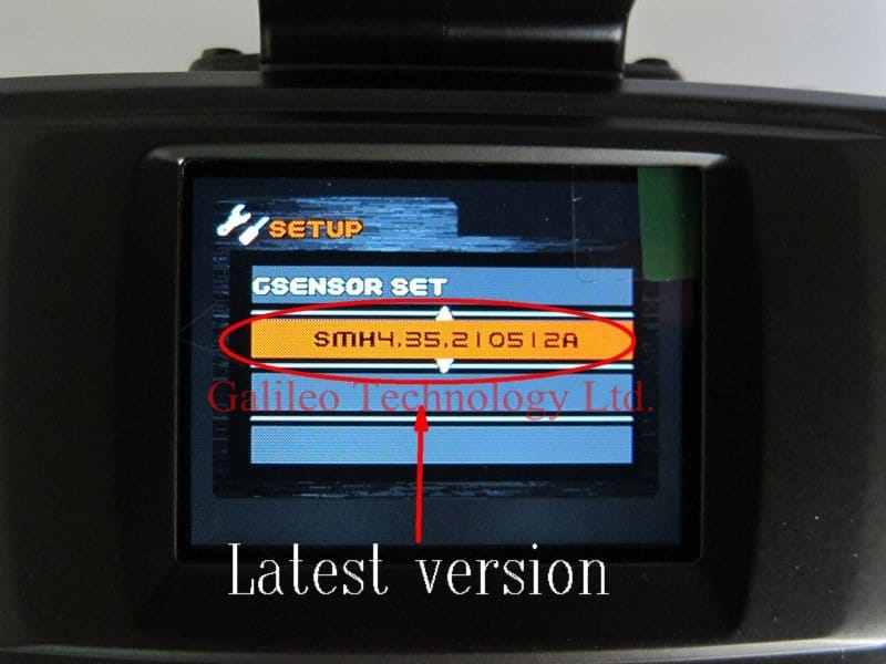

The New Orange Menu is an Ambarella A2S processor based camera as well and can be identified in a few ways.  It has an orange menu like this.
GS1000 Menu
This camera typically comes with firmware v4.35.210512A or similar.  Also the date, time and speed appear on the bottom right corner of the video.
The quality of daytime video and night time video is better than than Blue Menu camera.  Even though the night video is better than the Blue Menu camera, the night quality is still below average.  The bitrate is somewhat low at 7,000 kb/s which causes some pixelation when driving near trees.

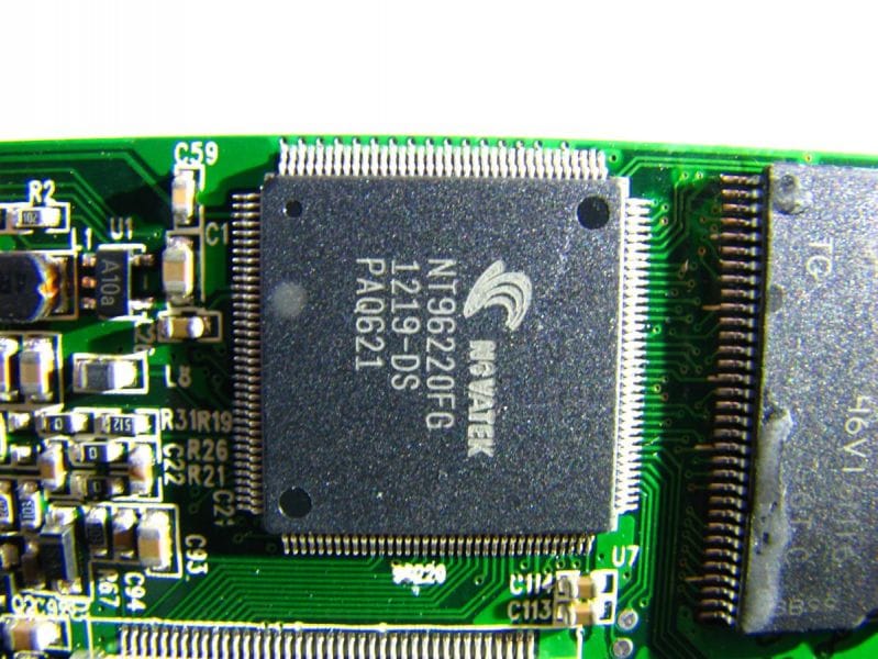

Fake Novatek
Many fake GS1000’s are now being sold now based on the Novatek processor instead of the Ambarella processor.  Typically this camera does not come with GPS and has poor to average video quality.  The price is usually under $50.  Comes with firmware such as DVR-B709.20120626-A.  Sometimes this camera is called the VG12.  Here are some photos of this camera.

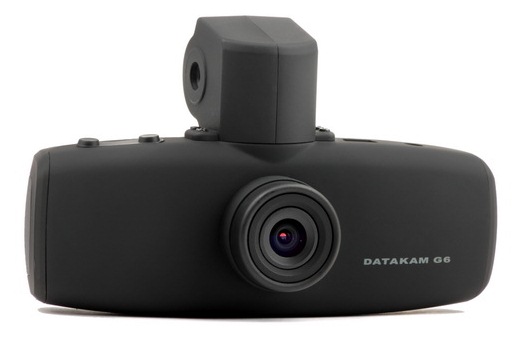

DATAKAM G6
There is a Russian DVR called the DATAKAM G6.  This camera appears to be based on the GS1000 and has the same Ambarella A2S60 processor.  However, it appears to have some higher quality components and options.
  • 5MP Micron APTINA CMOS sensor
  • Transystem Taiwan 51 channel GPS module
  • STAROPTICS Taiwan optical glass
  • Adjustable bitrate from 6MB/s to 15MB/s
  • Rubberized housing
Unfortunately, this camera only appears to be available in Russia and the cost is quite high at over $200.  Given the interesting specs, hopefully this camera will be available from some of the reputable Aliexpress vendors at a reasonable price.
Here is a night video.  Unfortunately even with the better specs, many users complain that the night video is below average.  Note the yellow font, speed in the top left, date and time on the bottom left and GPS coordinates in the bottom right.

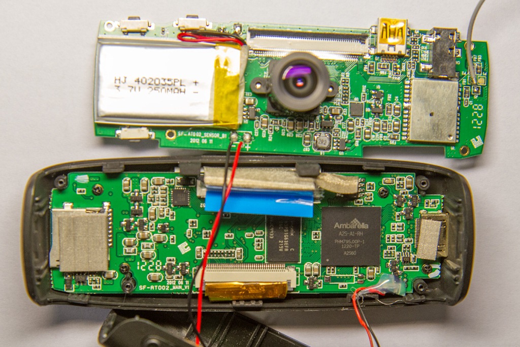

Disassembling the dash cam
  1. Unscrew the four screws on top, remove the side mount unit with a GPS module inside
  2. There are 4 tabs, 2 on top 2 on the sides, just at the bottom of the grooves. Gently press against the plastic shell to open.
  3. Remove 3 or 4 screws and remove the top board

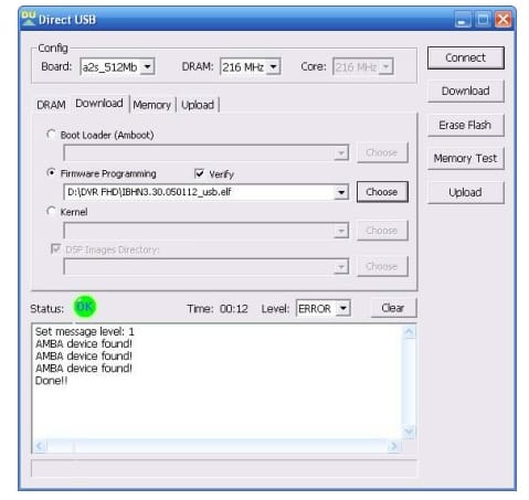

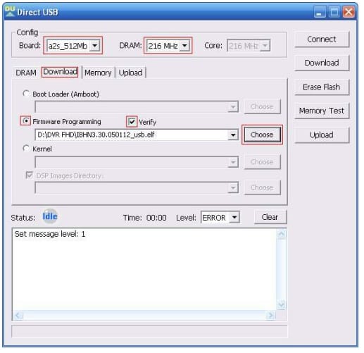

Firmware Update via USB

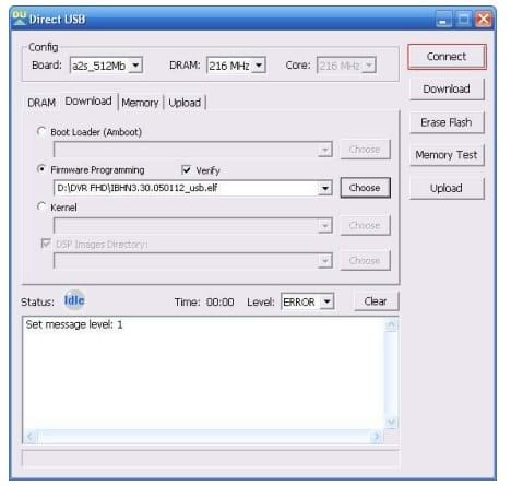

An alternative way to update the GS1000 firmware is via USB.  You must connect the GS1000 dash cam to your computer via a USB cable and use the Direct USB Software to manage the firmware.  The Direct USB software is only applicable for dash cams that use the Ambarella A2 processor.  Firmware installed via usb will have a .elf extension.
  1. Download the Ambarella DirectUSB_Setup_a2s_20090721.exe
  2. Run the installation program DirectUSB_Setup_a2s_20090721.exe
  3. Follow the installation wizard.

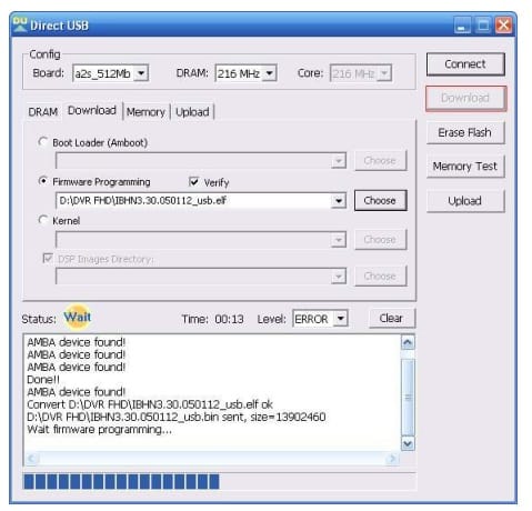

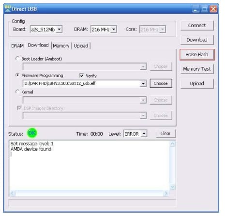

  4. Copy the following board.ini file (right click and save) to the Direct USB installation directory. You can view this in notepad, it is just some configuration settings for the DirectUSB software.
  5. Run the DirectUSB program and set the following parameters (highlighted in red boxes):
  1. Depending on the dash cam, select the appropriate firmware file.

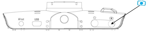

  2. The camera needs to be in USB Boot mode for it to work with DirectUSB. The computer will then recognize the Ambarella Evaluation Board and install the driver.  Getting the camera into USB boot mode can be a bit tricky.  Here are some ways to do this.
    1. Option 1 (Typically Blue Menu Cameras): Press and hold the OK button, connect the camera to the computer via the USB cable, then press the power button.  Hold for three seconds then release the buttons.
    2. Option 2 (Typically Orange Menu Cameras): Connect the camera via the USB-cable to the computer. Press and hold the “photo” button on top of the camera.  Without releasing
      the “photo”, click «Reset» bottom of the unit.  Hold for 3 seconds then release both
      buttons.
    3. Option 3 (Typically Orange Menu Cameras): Press and hold the “photo” button on top of the camera. Connect the camera via the USB-cable to the computer.  Without releasing the “photo” button, click «Reset» bottom of the unit.  Hold for 3 seconds then release both buttons.
  3. When the Found New Hardware Wizard appears, select automatic installation and click Next, or select the driver installation folder manually.
    For example: C: \ Program Files \ Ambarella \ DirectUSB. When you install the driver, click “All Continue anyway “in the box.
  4. Installing new hardware is complete.
  5. Note if you are unable to connect the dash cam to your PC , you may need to disconnect and reconnect the internal battery.
  6. Click «Connect»
  1. Once the status changes to “OK”, click «Erase Flash»
  1. Wait for the process to complete
  1. Then click download
  1. Wait for the process to complete.
  2. You should see the  «Firmware Programming Success!» message.
  3. Disconnect the USB cable from the dash cam and computer.
  4. Restart the device by clicking on «Reset».
The full Direct USB user guide is included below that describes the firmware software in more detail.
