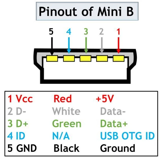

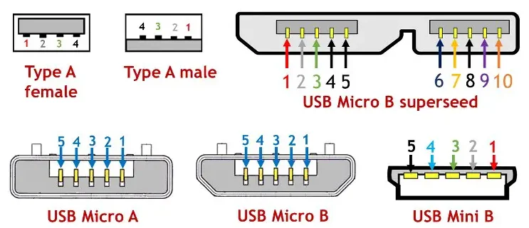

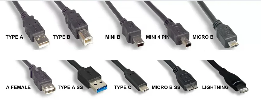

Just to help clarify connectors for anyone else reading this, here are some images from the web of USB connectors and pinouts.
The older dashcams seem to use the USB Mini B plug and some of the newest ones use a USB C.
Hope this adds more clarity and not more confusion.
Cheers !
