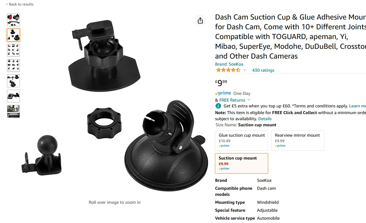

Might be a bit of work but you might be able to file off the pertruding piece on one of these 3m mounts and stick the interior cam to that?
View attachment 61563View attachment 61564
There's also a lot of magnetic swivel mounts like that. I could just ignore the magnet and glue the camera to the wide flat surface the magnetic swivel mount provides.
I found this one as well: https://www.amazon.com/gp/B00QSFKJ8E I could buy two of these and connect them back-to-back.
That also brings up 1/4-20 camera mounts. Since there's any number of mounts for cameras that end up in a 1/4-20 screw, if I can find something that has a 1/4-20 threaded hole that I can glue the camera to, it should work.

One very easy solution would be to buy a camera that comes with a simple ball joint mount and simply mount it backwards facing the interior.
@Skylar132 's suggestion would not be difficult either. I've designed and built a number of custom DIY windshield mounts using modified parts from pre-existing dash cam mounts. There are many possibilities if you have some DIY skills and a little creativity.
One solution I used one time that is very simple and works quite well is to epoxy glue a 1/4-20 threaded hex nut directly to a strategic spot on your camera (depending upon the camera as to where to place the nut, of course) and now you can mount the camera on ANY mount that has a tripod screw.
I happen to have one of those iSaddle mounts that you linked and they are excellent. I've recommended them here on the forum. They are really well made and very secure once you adjust and tighten them. I don't think it would be the best mount for your project however because it would be awkward and difficult to adjust each time you want to change where your camera is aiming. You would want a simple mount that can be easily turned from side to side without it going off in multiple directions each time you loosen the thumb screw as the iSaddle mount will because it has multiple articulation joints for adjustment that all loosen at once when you loosen the screw.
Here I was thinking of using something like this or this to have more surface area to glue to it, but a hex nut would definitely work if you're using a more permanent adhesive like epoxy.
