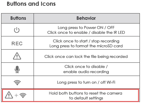

The user manual shows that pressing "Video Protect" and the "Wi-Fi" buttons together should cause the A139 Pro to revert to the default settings.

Easy fix for the A139 Pro WiFi password reset:
•Power up camera.
•Stop recording (hold REC button).
•Hold the yellow triangle + WiFi button
•You should see all four lights flash.
•Password is now 12345678.
If you have first hand experience then share it but it doesn't help just to repeat what the manual might say. Things get changed on models with firmware updates.
