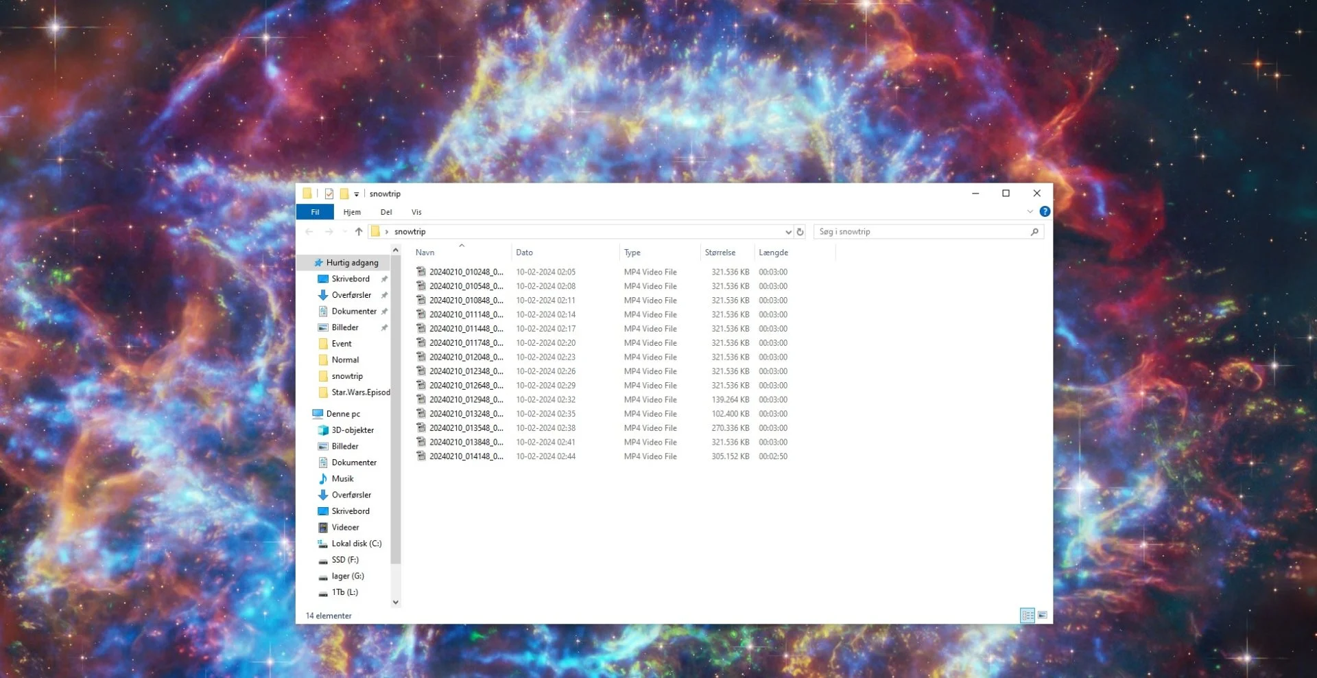

Okay i had something weird happen with the N5 recordings from the front camera, wanted to compile a drive video driving to my friends house at night during a snowfall.
And everything is fine, aside for a couple of files in the middle of it all, towards the end, their file size are much smaller for some reason, resolution / bitrate check out just fine, and it is also 3 minute segments, CUZ dropping them on the time line of my video editor program those files are the same physical size as all the other files.
