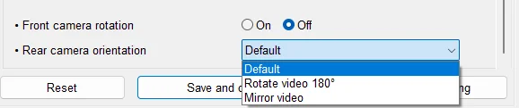

You can rotate a BlackVue front dash camera in the windshield mount so that you can place the lens on the right side (facing forward). In the firmware settings, there are two settings for the camera orientation (one for the front and one for the rear). I just ran a test with a DR900X-2CH Plus changing the "Front camera rotation" to "On" and the video was correctly oriented when the front camera lens was on the right side facing forward. The windshield mount allows the camera to be rotated a full 360 degrees which allows you to place the front camera lens on the left side or the right side facing forward. With the front camera lens on the right side, the writing on the front camera case will be upside down, but it's still functional in that orientation.

i have the blackvue dr750x plus and its mounted in a uk rhd merc to the left of the rear view mirror shroud, i then discovered you can spin the whole camera 180 degrees then rotate the lens if that makes sense, next one i buy i will prob just mount below the rear view mirror or on the drivers side of the rear view mirror
