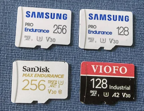

From the 70mai web site:
Dash cam supports microSD card with a minimum capacity of 32GB and a read/write speed of U3 (UHS-3) and above.
The A810 is not compatible with the Sandisk Max Endurance 256G and can be formatted, but it stops working after 1 second of recording.
The Samsung Pro Endurance 128G & 256G works well without any issues.
I don’t like Samsung cards :/
Sandisk was my main driver for a lot of time.
Wonder if the Sandisk will be supported with firmware update.
What's not to like? The Samsung Pro Endurance are rated to last longer than the Sandisk High Endurance, here it's 5 years warranty vs 2, but Max Endurance should last the longest

I have Max Endurance 256GB
I need to change to Samsung Pro Endurance for the A810 ?
