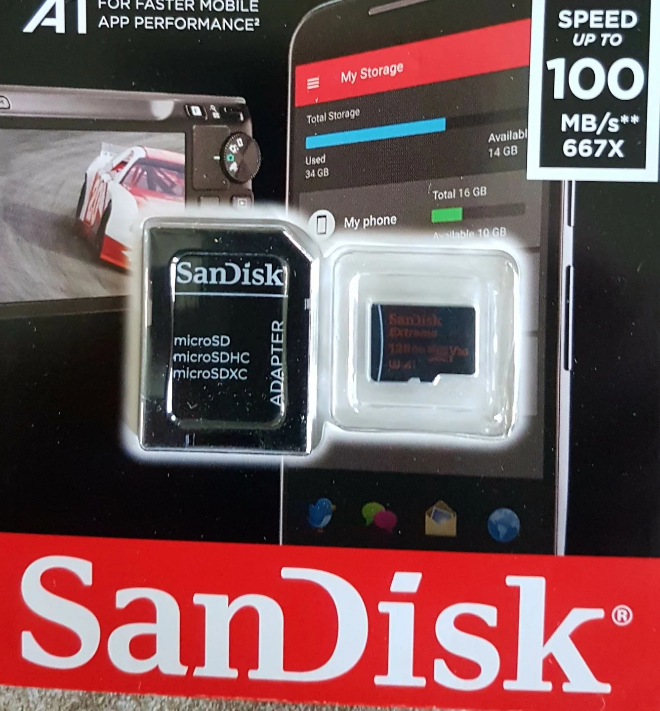

I successfully used one of these 128 gb cards in my F770, I transferred it's use to my F800Pro along with an extra card exactly the same to cover a long period in two countries, they have operated faultlessly throughout, so I stand by my confidence in this card.

Which Sandisk card is that as I can't see the model etc from the photo?
Hello TBF.
I agree it is difficult to read it with the dark background, anyways it's a Sandisk Extreme 128gb V30 and just to confirm I have now used these two cards for almost a year and they have performed faultlessly.
J.
