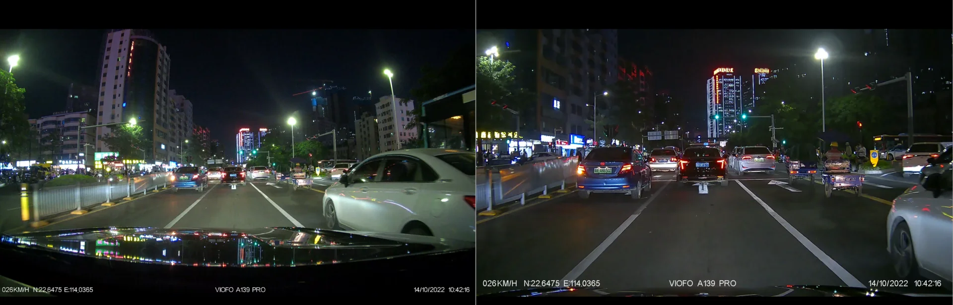

I also did some testing with a telephoto lens, it is only a little longer than the current rear cam lens.
It's good enough to read the license plate of the 2 cars in front. :)

At about 2x zoom, or half the width of the regular camera, I find that a modest telephoto view can be useful.
I might run this telephoto camera alongside my A139 Pro, similar to your example.
Little more zoom. Please.
I was thinking I could try replacing the 6mm F1.2 with an 8mm lens, also for a little more zoom. I need to check a few dimensions first to see if it works.
