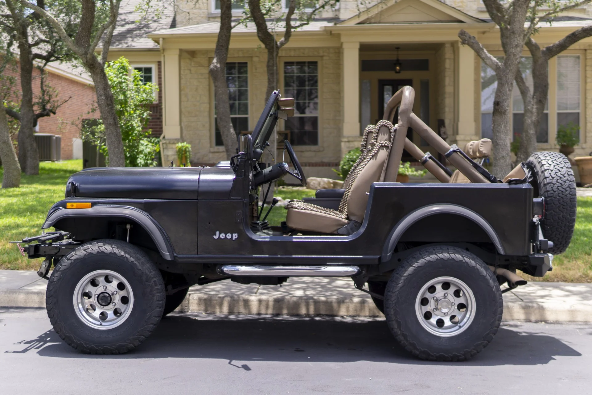

Thanks for the input. I appreciate the suggestion of the d'Action 360. I'm currently reviewing it and am leaning towards it.
This isn't something I thought of on a whim, I've researched it as much as I can over the past several years because I've had a unique application. Technology just hasn't gotten to the dash cam market at all. Cameras have remained the same since about '17 and they only add on features you don't need. No real improvements since everyone wants a cheap <$200 camera that does everything. See the exact same crap in the CCTV monitoring market. You have to get a <=1080p sensor if you want any type of low-level light capabilities and still it's pathetic.
At first it was for 1 vehicle that always remains open without security ( no door or top '85 Jeep CJ7 ) but now I have a fleet of 5 with my children driving. Not everyone's life situations are the same. 3-4 channel setups in my kids and wife's vehicles, with wiring running all around, just isn't practical right now. It's obvious that 360 in a single unit will never equal having 4 strategic cams but it's the next best thing for my particular circumstance. Instead of pounding desks, and trying to get everyone to bow to your elite setup, it would be better served to understand the reasoning behind the request. We see it all the time even like the mountain bike forum I below to. Members pounding their desks dictating that you have to use their trail-type carbon fiber frame with 29" wheels, drop seat-post, and 4 piston brakes for ALL types of riding even if you're doing bike park downhill otherwise you're an idiot.
My cousin is a lawyer and I've also reviewed this with her. In our municipality, I can edit the goofy 360 video so that it appears normal on anyone's PC. Heck, even post it on Youtube for them to see with their cell phone. It will uphold in court as long as I supply the original video file showing I didn't DeepFake something on it.
I'm editing video all the time and it's not that big of deal.
I'd just get the GoPro 360 for all of us if I didn't have to rely on my kids to start and stop the recording every time they went for a drive.
Kinda hard to do a 4 chan on this guy, not look stupid and have it easily removable;
