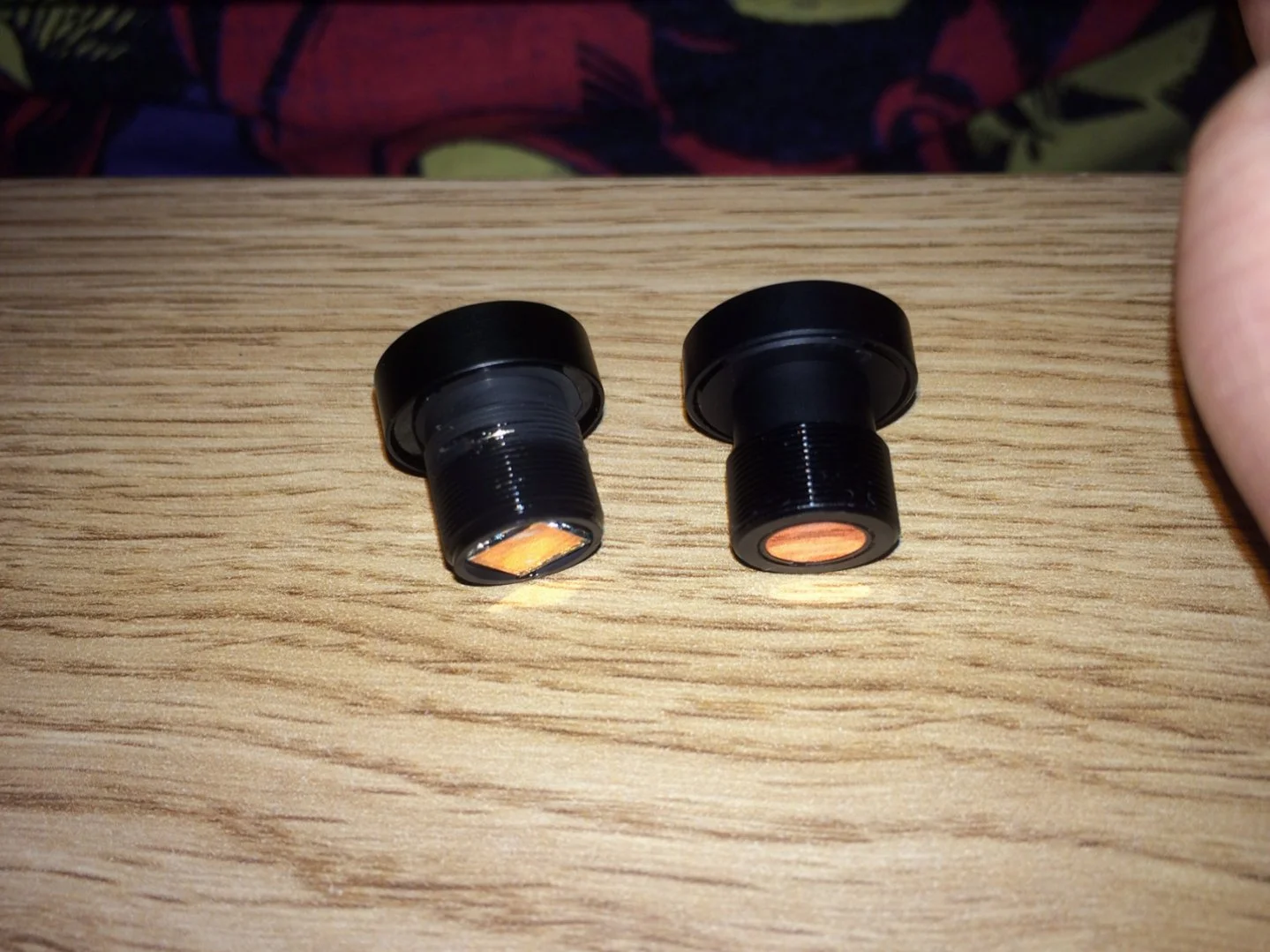

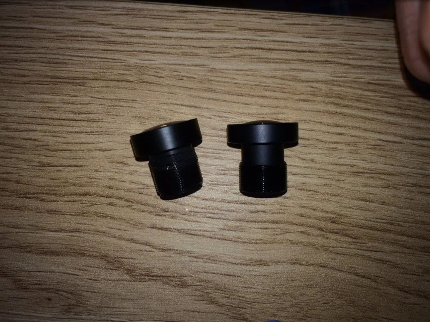

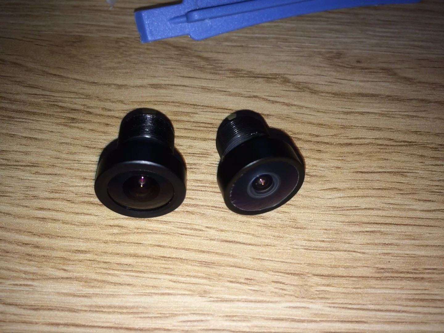

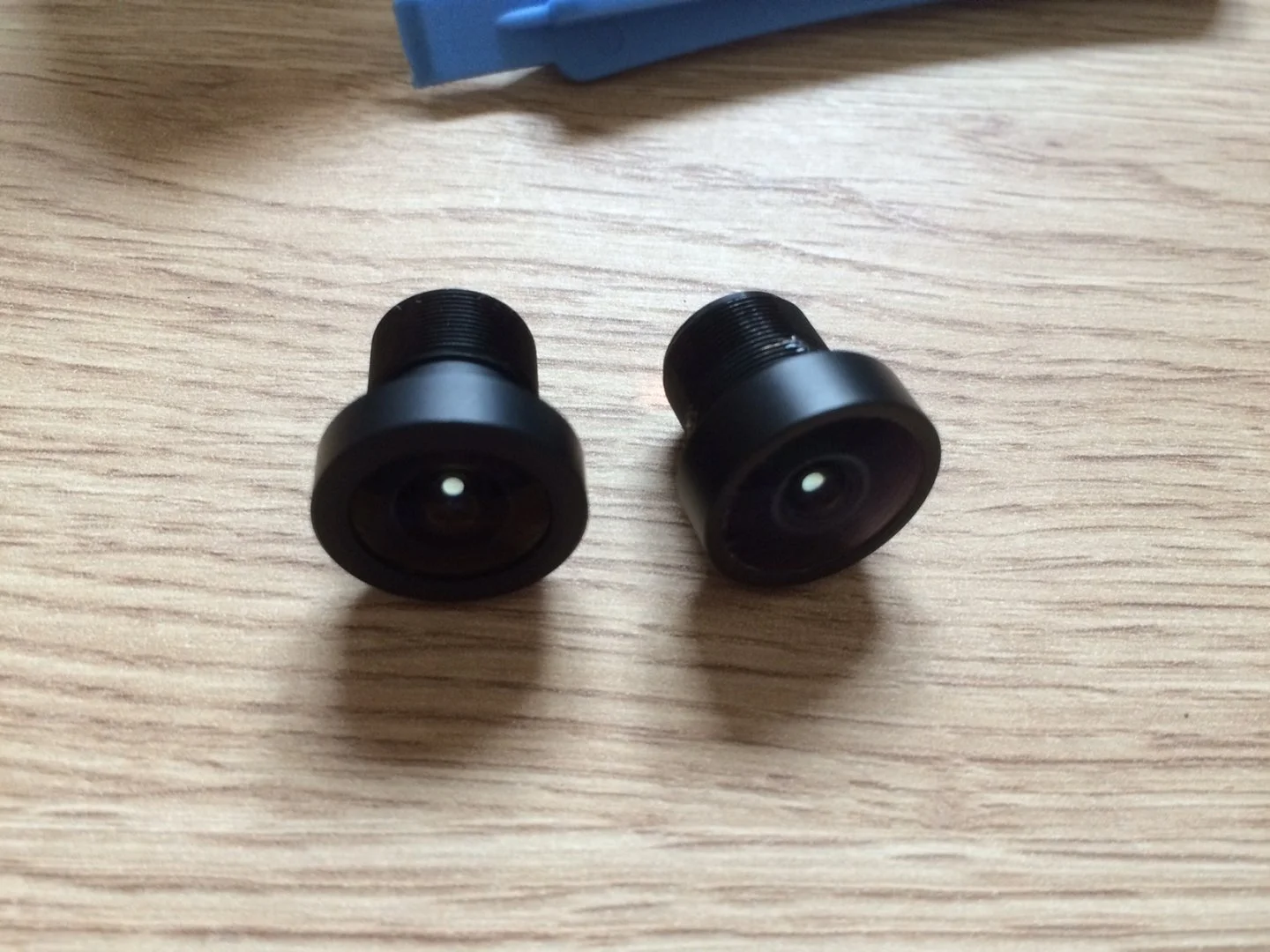

You can see from the pictures the differences between the two - the factory G90 lens uses a square IR filter whereas the Mobius one uses a round one. The threads are slightly different but other than that they're the same thread and the same width at the top.

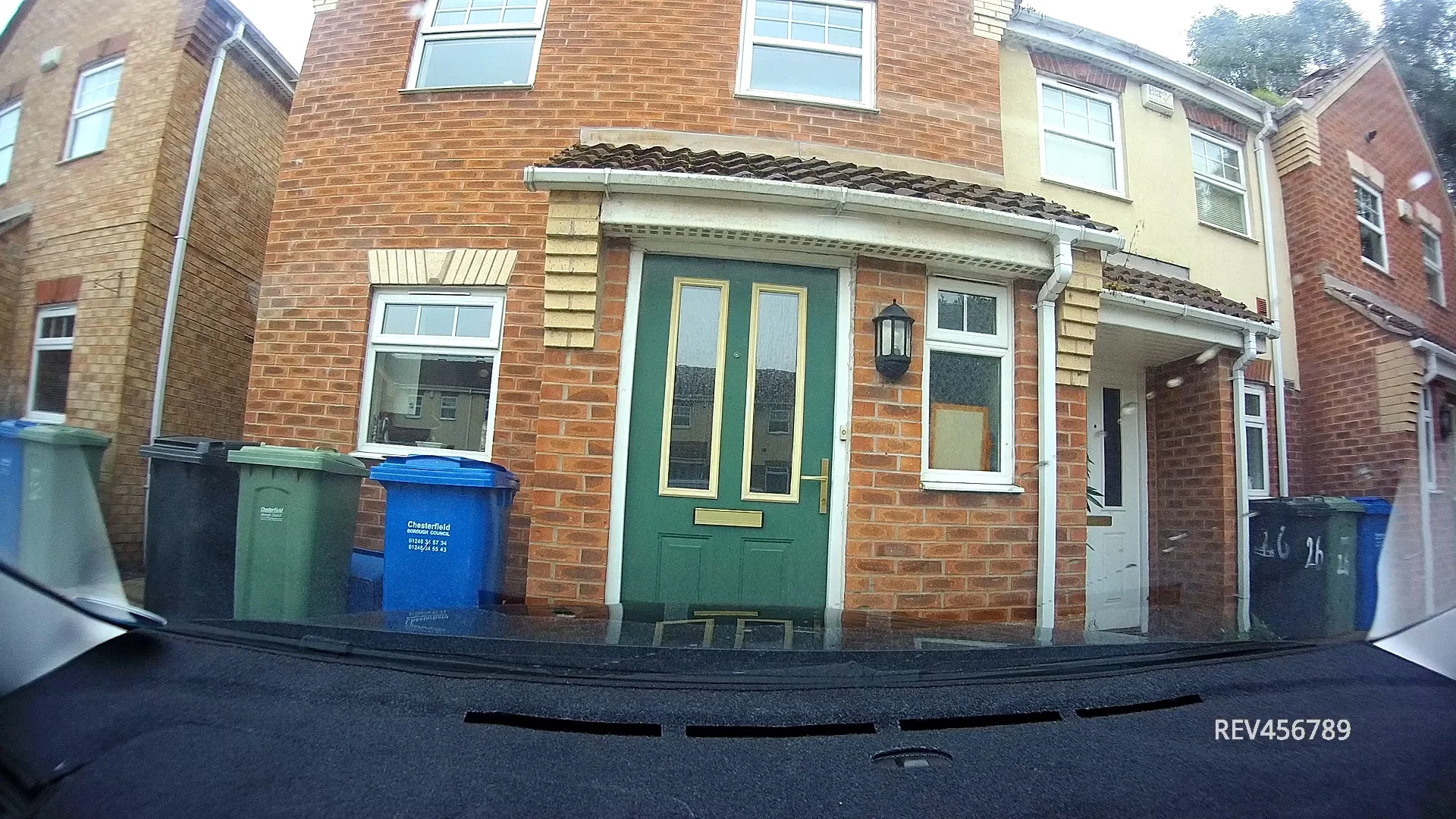

It turns out the Mobius B lens has a much wider FOV than the factory G90 lens which you can see from the below captures (both from the same G90, just a different lens):
The wider lens also causes things to look further away, so numberplates etc will be smaller and footage of someone cutting you up doesn't look as dramatic. The very top extreme corners are slightly out of focus but to be honest you're never going to see a numberplate you need up there (unless someone is going Dukes of Hazard on you or you've got the Doc's Delorean flying overhead in which case his reg number is OUTATIME anyway!)

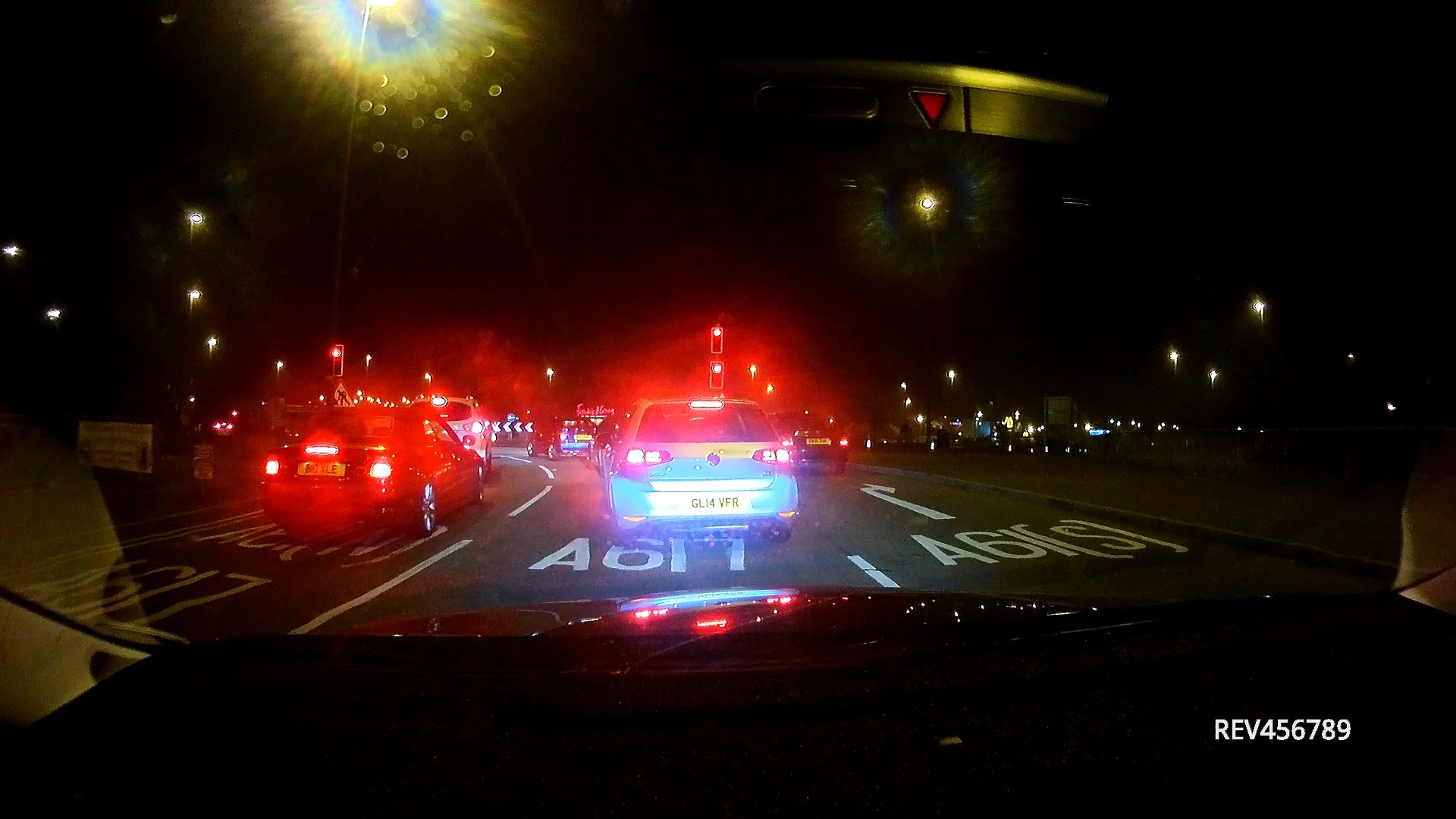

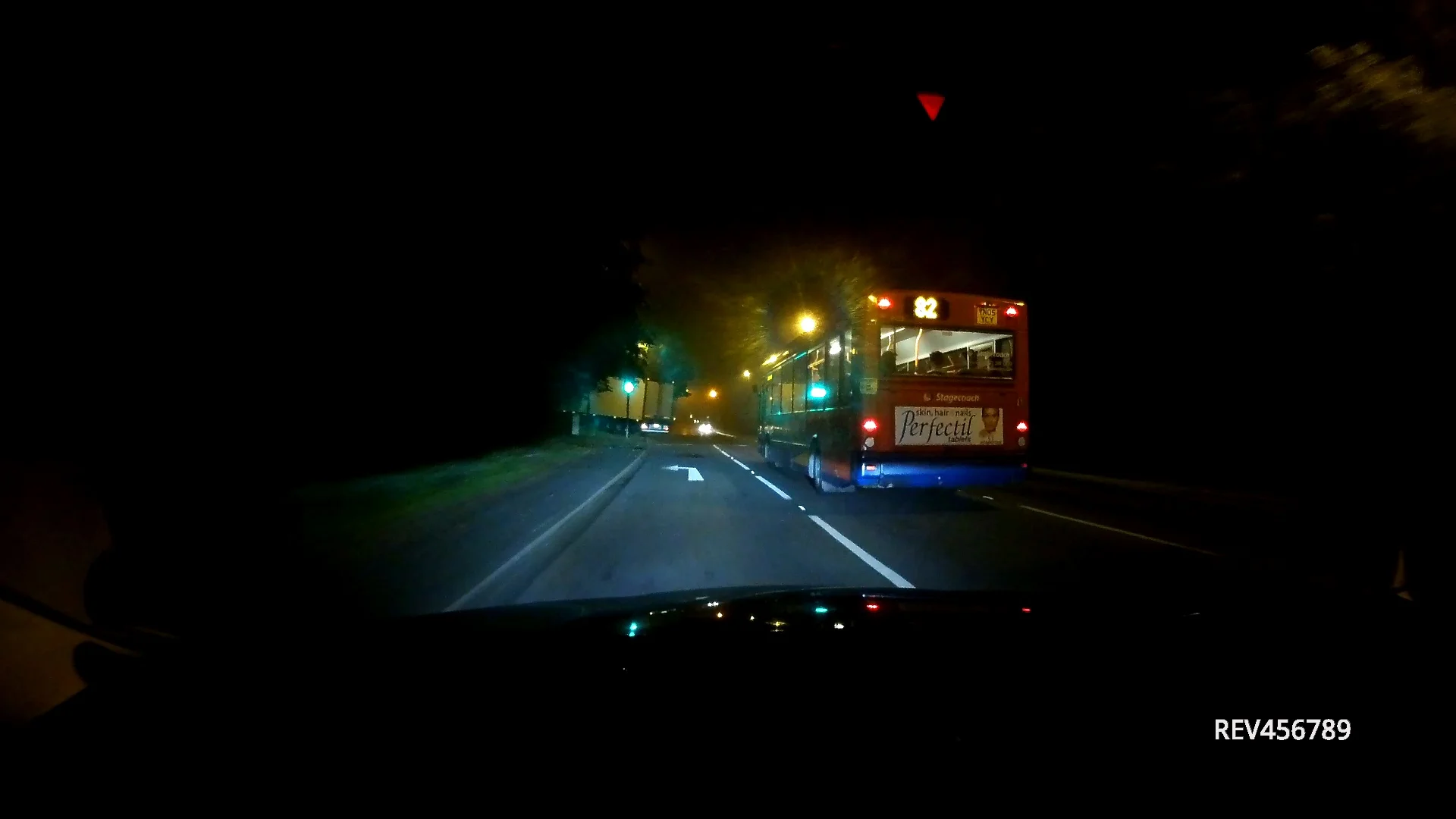

Anyway here are the results:
