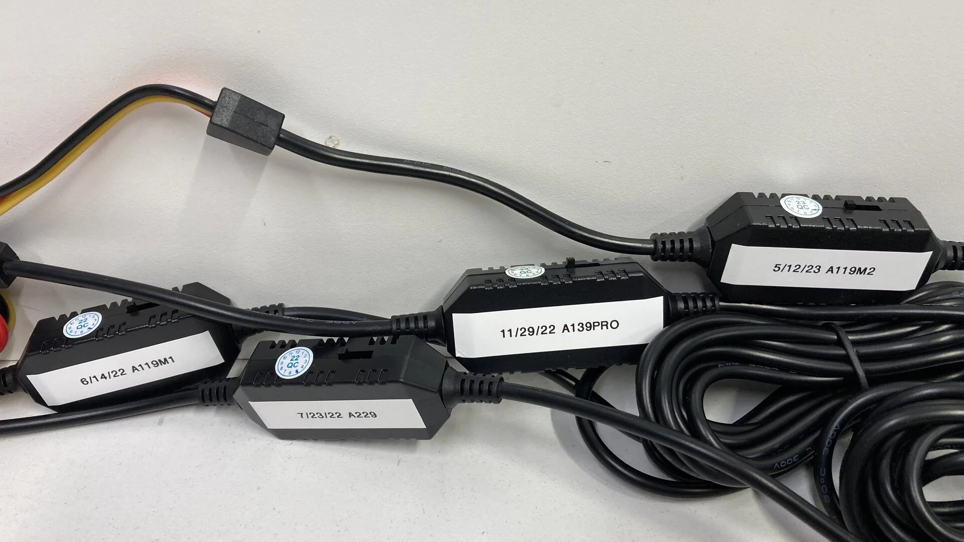

I was checking the various HK3-C hardwire kits that I have on-hand. I found that the more recent "upgraded" units have "20AWG+24AWG" on the black USB-C cable insulation, while the older units (pre A139 Pro) only have "24AWG" on the black USB-C cable insulation. @Panzer Platform is that true of the HK3-C hardwire kits you have?
AFAIK, Viofo has been migrating to thicker AWG wires in their cables across the whole product line over the last several years.
Correct.
It appears all Viofo Hardwire kits manufactured after October 2022 (check date code sticker), have the "upgraded" thicker wires (20AWG+24AWG) irrespective of what type of USB-C connector it has, (straight for A139 series & right angle for everything else).
