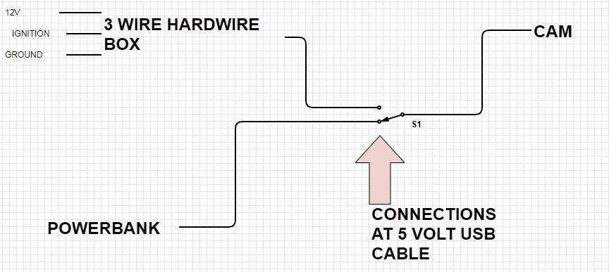

For those interested in being able to use a switch to change from vehicle power to PB power. I think this should work.
It is best to use a 2 pole switch to switch both 0 volts and 5 volts, then you can safely charge the powerbank while the camera is connected. If you only switch the 5 volts line then you should not attempt to charge the powerbank from the car.
Indeed, this is just for switching power over from the car to the PB.
