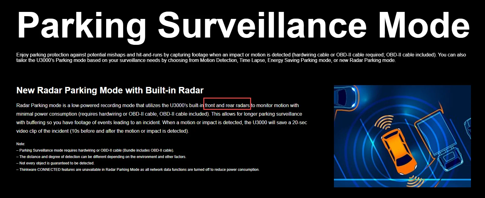

For me the problem is latter i.e. the rear camera radar does not detect motion in parking mode as advertised by Thinkware. I spent $550 for this exact feature. My car is brand new and has all OEM parts in it.

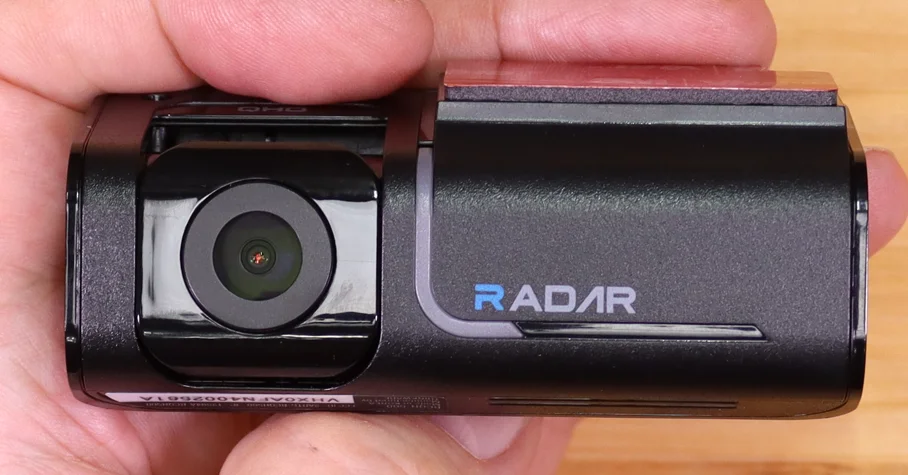

Push the rear camera plug harder for it to click the final couple of mm. The plug has a groove around the end, I only pushed the plug until the front camera announced the rear camera is connected, but in parking mode movement wasn't being detected. The plug wasn't fully engaged which powers up the radar it needed more force to fully engage it. Two pins in the plug are shorter and require that last couple of mm to connect.
