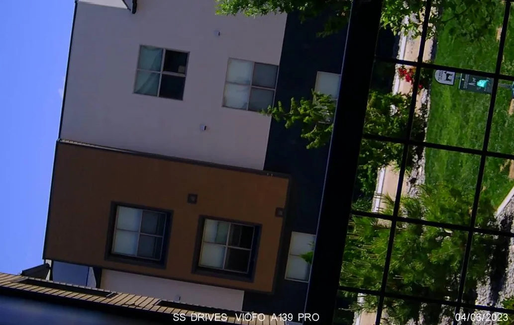

Any tips for improving image stabilization with telephoto/zoom lenses? I'm getting a lot of movement from the bumps in the road, but the lens pivot itself isn't moving. Heres an example:

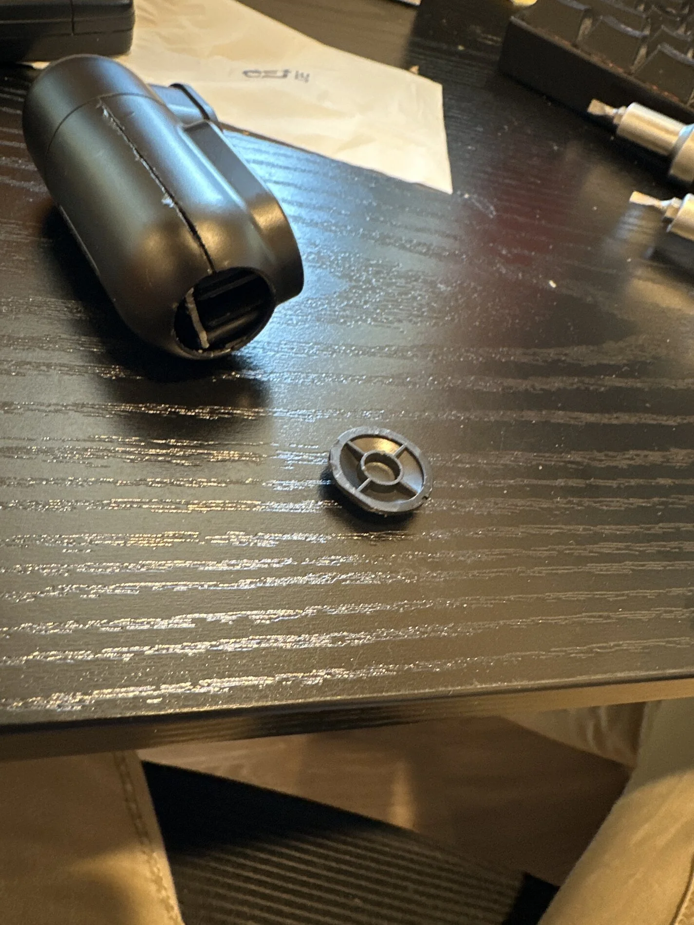

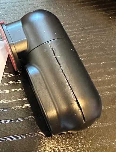

Any tips on getting this camera apart? I've been picking at the seams perpendicular to the lens direction but am struggling a little bit:
Edit, managed to pop this out, but can’t seem to split it at the rotation joint:

To save others the trouble and the damage - the port side has a cover that pops off, there are 3 screws there, remove those.
There are two other screws in recessed holes, easy pz.

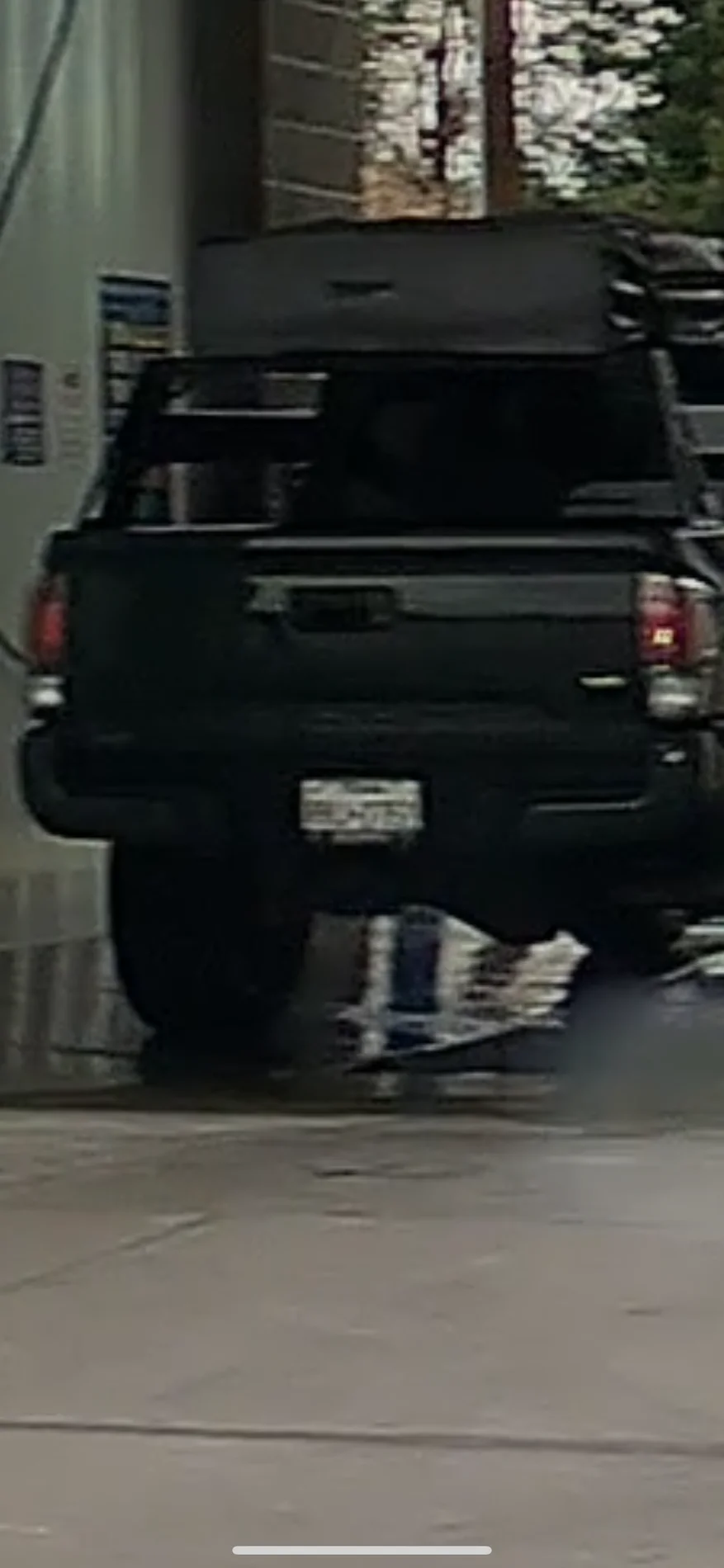

Here’s some comparison:
Of note, telephoto picked up this plate when the main camera missed it:

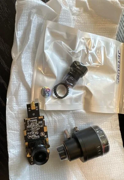

Hey, I'm doing the same thing as you did. I haven't yet opened up the dashcam to attach the lens, how did you do it/what did you use to attach it? I'm currently have the lens in the bottom right of the picture.
The cover on the side of the dashcam pops off to reveal 3 screws. Really no force should be necessary, I mauled my dashcam thinking I needed force.
The lens threads into the existing thread pattern in the dashcam (after removing factory lens)
Which exact lens do you have, can you send a link? The one I ended up using fits through the factory hole in the dashcam housing which is helpful.
This is the lens I got; https://www.amazon.com/gp/B07GHZ5BBZ

The vertical angle adjustment on the A139 (& Pro) is only held in place by friction. I would be concerned that a relatively long and heavy varifocal lens may droop over time due to bumps, vibrations etc. Could be worth trying though.
Just needs a counter-balance on the other side!
I think there is quite a lot of stiction, so it doesn't tend to creep, but then a pothole might move it without you noticing, just before the important event.
@TonyM is absolutely correct. A varifocal lens is not a wise choice for this installation because of its weight and size. It will likely get dislodged by bumps in the road and other shocks such as slamming your door shut or making abrupt stops. This lens will also be subject to image compromising micro-vibrations on all but the most pristine road surfaces. This varifocal lens is 45 millimeters long and weighs 34 grams and therein lies the problem. The rear camera module was never designed to support a lens of this size and weight. Additionally, in many installations a lens that long is very likely to hit the glass of your windshield and make the installation difficult or even impossible.
Nigel, considering that you've been railing against the use of telephoto lenses on dash cams for years now, I doubt that you've ever seen or handled one of these varifocal lenses to understand exactly how heavy they are but a "counter-balance" would be an impractical and unworkable solution under any circumstances. I'm pleased to see that you acknowledge that a pothole might move the lens but you would indeed notice that the lens has shifted position and it wouldn't take something as severe as a pothole to make it happen.
As the guy who first introduced the concept of telephoto lenses on dash cams here on the forum six years ago, specifically with the use of this type of varifocal lens and who along with @TonyM and a stalwart group of other DCT members have been exploring and using these telephoto lenses (and others) for years, it's probably best to listen to people who have actual experience with them rather than from someone who merely offers opinions.
If I were installing a remote telephoto lens on the A139 Pro I would opt for one of the megapixel primary lenses that have already been discussed in this thread, available from AliExpress, either the 8MM or 12MM.
This is the one I used. For that big varifocal, you will need to drill out the camera front plastic cover to get it to clear the housing.
