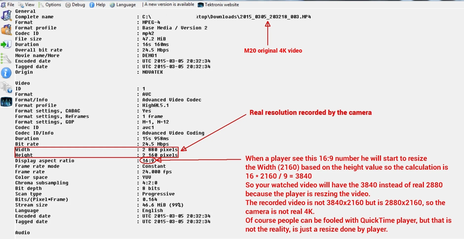

Good luck to you also buying an ORIGINAL camera mentioned in this thread that shoots faked 4K and uses a 4Mpix sensor which is interpolated into oblivion with FAKED 12,14 or 16 Mpix pictures !

The Gopro Hero 4 produces 4k video which is "native" a true high definition video, all the cheap cams are not native! They produce a fake, and fool gullible buyers!!
