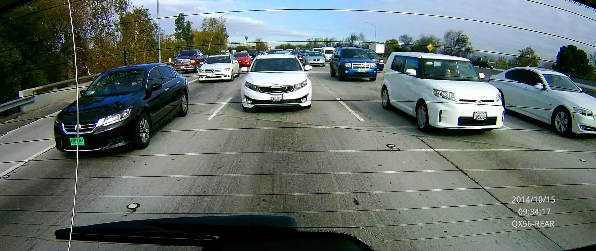

Just started a couple days ago. Running Firmware version G-90-A770-553-N-H
Shows up in photo mode also.
when in "playback" mode, the line is not there. Looks to be an issue with the sensor, no?
pressed the reset button but no change.
minor annoyance but would like to know what it could be.
again, this is a brand new cam. had this newest firmware on here for about a week or so.
im leaning towards a physical issue with the sensor.
Any thoughts gents?

as I suspected.... ;)
If I change the resolution to something smaller (2304 X 1296), I get two lines.
In your opinion, no reset will fix this eh @jokiin ?
that helps. thank you. ;)

yeah I know it's of zero help and wish I could offer you some hope of recovery but not the case unfortunately, no one wants to be the one that has to break the news about a death in the family
hahaha no seriously, thank you for the confirmation! :) thats why I put a smile there so you understood the mood is jovial and at peace!
The line could be all over the screen or a big white block like in the first one I had (remember? :) ) so its not a major kill. I even stated this in the opening post.
I would like to see about getting the cam replaced (again) and have opened a ticket with @JooVuu in regards to this. we will see how that goes but in the meantime and between time I wanted to ask on the forum if anyone knew if this looked to be firmware or hardware.
I too was leaning to hardware in the sensor because when I switch over to playback mode, the white line is not on the screen. this leads me to believe its the sensor.
again, im not sad or mad or upset. its hard to gauge ones tone over the internet. You really did help me @jokiin ... seriously you did, and I was not being sarcastic or mean.... :D
this cam is not a human and its not dead, just a faulty sensor it seems...o_O
As others have suggest the image sensor is most likely faulty :-/
It's probably nothing you've done as CCD and CMOS sensors can usually take quite a bit of punishment.
My old dashcam spent 2½ years permanently on the windscreen and live through burning summers and freezing winters in Slovakia and the UK and was fine (now relocated to the rear window) until replaced by my G90 A70.
Some lenses can discolour of may go out of focus (normally to one side) if they've used poor quality acrylic lenses, but the G90 uses glass lenses so this shouldn't be an issue.
Best send it back for a replacement or try replacing the senser yourself (perhaps with an even better one) ;-)
P.S. Laser damage tends to leave discoloured spots and splodges.

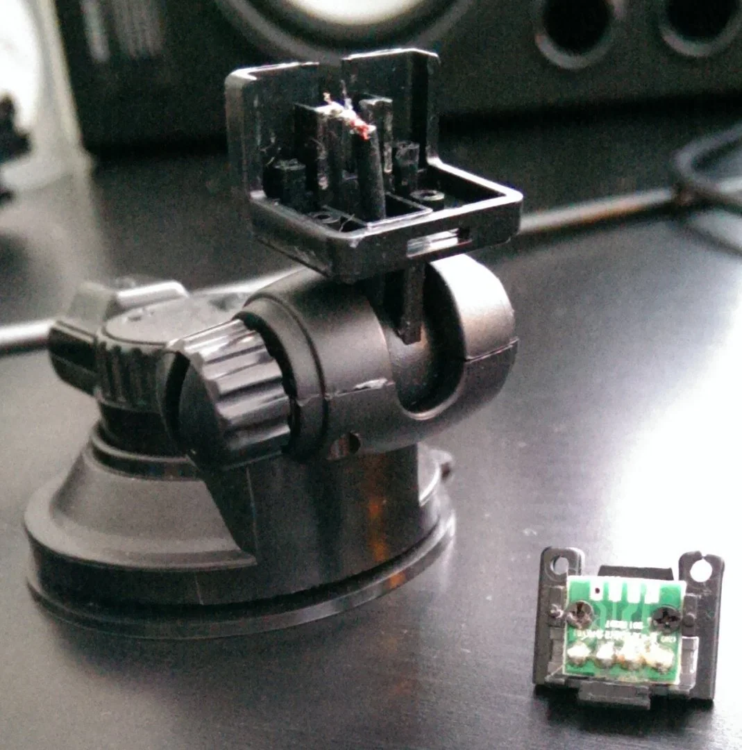

Right, so to follow up on this fiasco,
I went to take the cam off the mount and the circuit board came off with it!
There were supposed to be two screws to secure the board to the mount, but there were NO Screws :D:p:rolleyes: !!
The mount was just held in there by friction i suppose, and when I went to remove the cam to troubleshoot the white line issue, that's when I discovered it.
@JooVuu FINALLY responded to my ticket after a few days of radio silence only to say he/she will reach out to Dome to see what they have to say.
I have a $40 USD Novatek Gs8000L that has worked solid for two months 24/7 with no issues with the screen or the mount, yet I can't get one of these $100+ USD cams to work right out of the box! I have had two and both have given me issues.:rolleyes:
Perhaps @JooVuu had a bad batch since he/she was the first to offer this for sale or the QC at the Dome factory is awful.
regardless, I can no longer recommend this camera. AS good as the image quality is its just not worth the hassle dealing with an overseas vendor who is the middle man to a factory with poor customer service.
So now, all of my dashcam eggs are now in Panorama X2's basket. I am grateful for @Pier28 to be active on this forum plus knowing they are a few hours away really helps in my decision on where to purchase future dashcam products and accessories.
