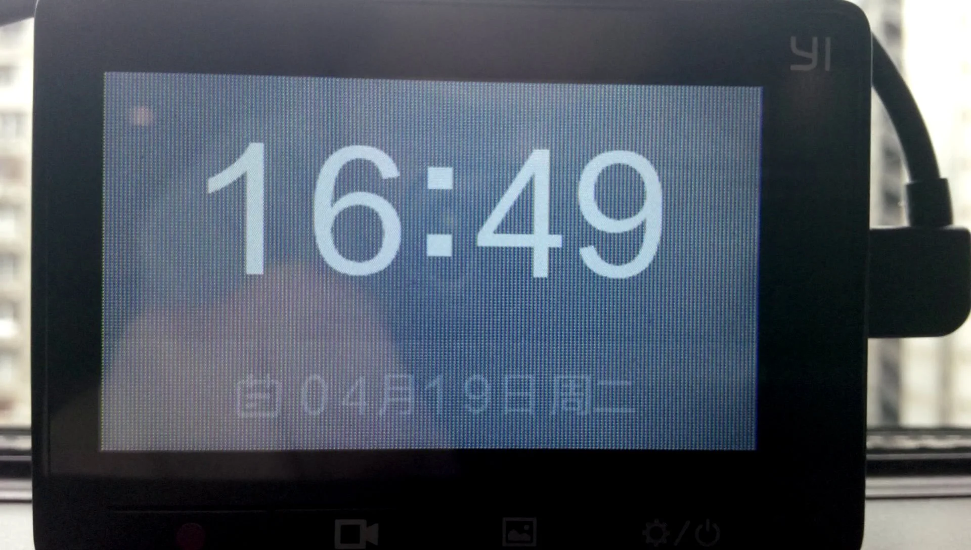

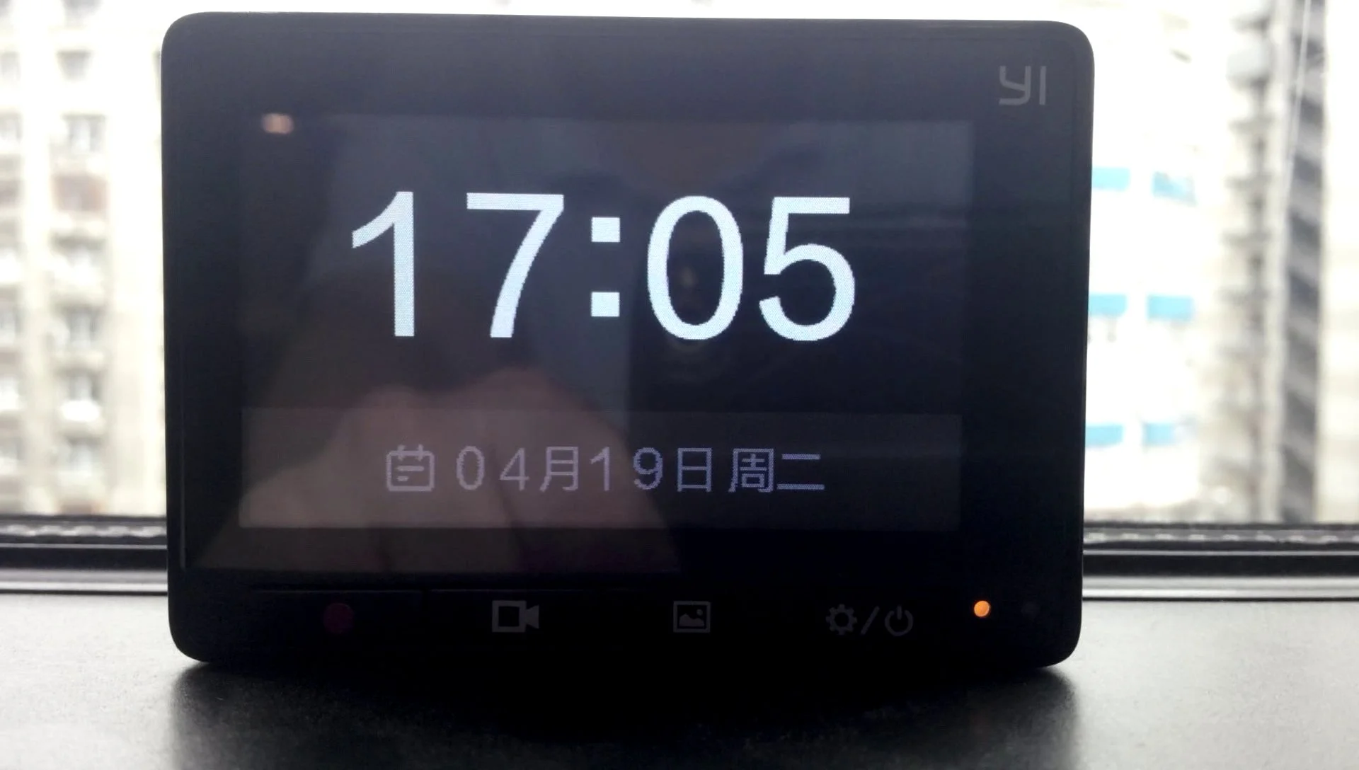

It is in tests right now. Turned it on half an hour ago, it is in the office, on the window filming outside. The LCD started to go white. But it is not suddenly, it is slowly turning white, I guess while it is heating.
It looks like half of the pixels are going off and the other half are turning brighter, alternating. I'll let it another half an hour and post some pictures.
