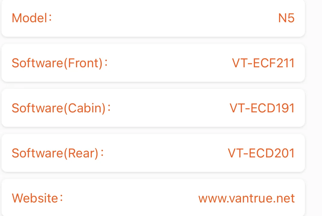

right now i'm on the below version
issues are:
issues are:
